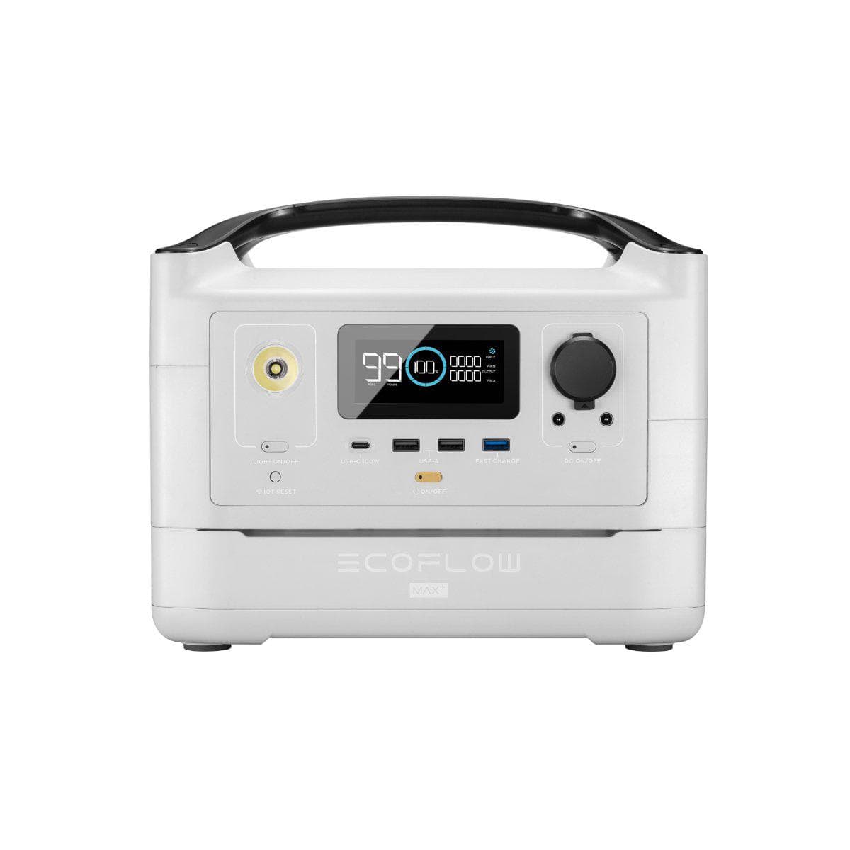

Yep agreed - I just have the standard River and it's the goods - can output 100w so the dual charger will charge 2 batteries and sucks in the juice to recharge

That is cool but I don't need something with its own battery source....
i thought you said on the go? if you don't plug your drone charger into the car battery then how else do you plan to charge it? solar? if you are not on the grid, you need a "battery source." lol
maybe you can try to use one of those plugs that insert into the cla / vpa socket and has a usb port where you can plug in the skydio charger w/battery. that should work.
