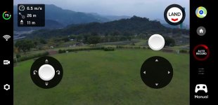

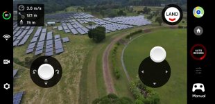

Just do a range and speed test.
Background information
  • With phone app only (without the beacon nor the controller)
  • Firmware 15.10.17
  • 15°C
  • Cloudy
  • Wind level 2
  • Open place
Test result
  • Max. speed > 6m/s or 21.6 kph (13.4mph)
  • Max. range ~ 120m (393.7ft)
Connectivity
  • Within the range of about 120 meters, the phone connection is good, and there is no abnormality.
  • Slightly more than 120 meters, the screen of the mobile phone was significantly delayed, and a lost signal message also appeared.
Operation
  • Acceptable and quite good
  • It will be better to operate with the controller. (I guess)
